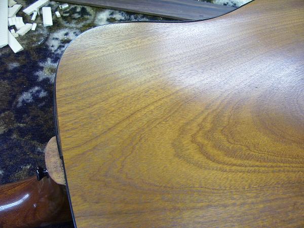

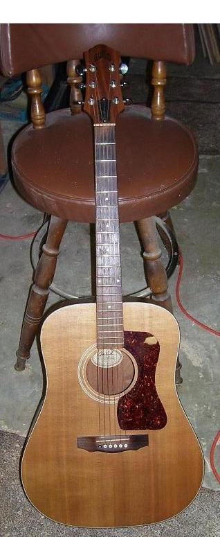

Anyway, I reglued this plastic binding on with LMI's FCA contact adhesive. Everything went well with the glue, but I have a couple spots where I removed the tape and some of the finish came too. Not all of the finish, but it left a light "shadow". That brown paper binding tape has some major stickum. I should have stuck it to my shirt a couple times to weaken it.
This picture is from before the fix.
It's a Guild dred with a so-called hand rubbed finish. Does anyone has a guess as to what the finish might be? It's a thin, very low gloss finish.
I was thinking I could pad on a little tung oil, and very lightly go over the whole surface to blend.
Thanks so much,

I'm not sure what the finish is, but if this was a westerly, R.I. Guitar it is worth a small fortune. I would make real sure of what the finish is before I put anything else on it.

I will try to contact Fender. This is the only picture I have here at work. I'll post one of the "effected area" tonight.
Looks like I'll be doing a bridge re-glue on this too. Had to check with the owner, he didn't know it was pulling up. He said go ahead, so I will probably replace his leaning plastic saddle with a bone one.

It's a D4HR. From what I found they started making them around 1991. Don't know if that makes it a Hoboken or a Westerly. It's heavily built and would make a good starter instrument. Can't say much for the tone, but the strings look as old as the guitar and the bridge needs major work.

[QUOTE=ToddStock] Hmmm...so I'm thinking the single black bridge pin probably does not make this guitar any more collectable, eh?
Kinda has a black eye doesn't it. Its a 5 degree pin in a 3 degree hole too, so it only goes about half way in. The pins are plastic so I bought 6 new similar pins for it so at least they will all match and fit the holes.
